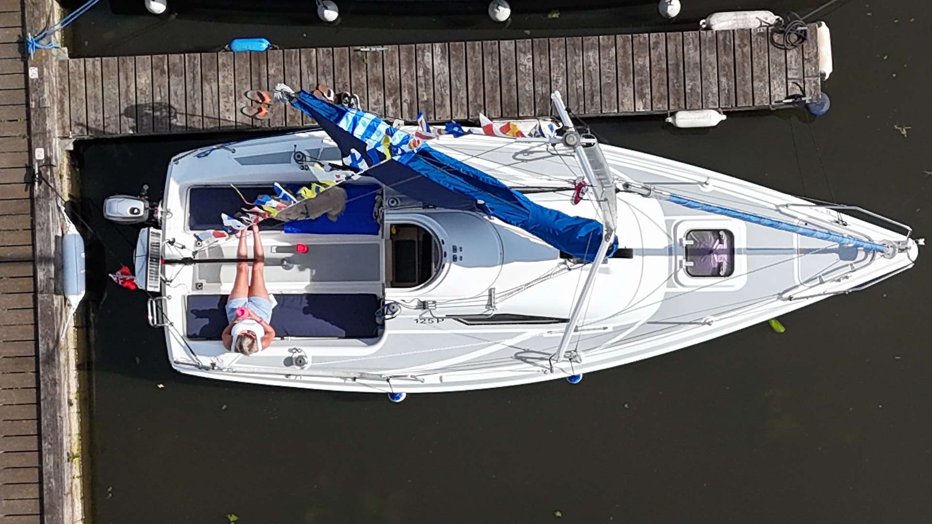

Hi, We have recently purchased a Sportina 700 which has lived its life in fresh water, she is in fantastic condition and has had little use. Infomation on these is in short supply and i have a question regarding the lifting keel system.
The lifting mechanisum is really hard to winch to the point i am concerned with the tension on the rope. Can anyone offer any insight into these systems and if there is anything I can do without lifting her out the water. We do not have a trailer and she sits on a floating mooring in the UK.
