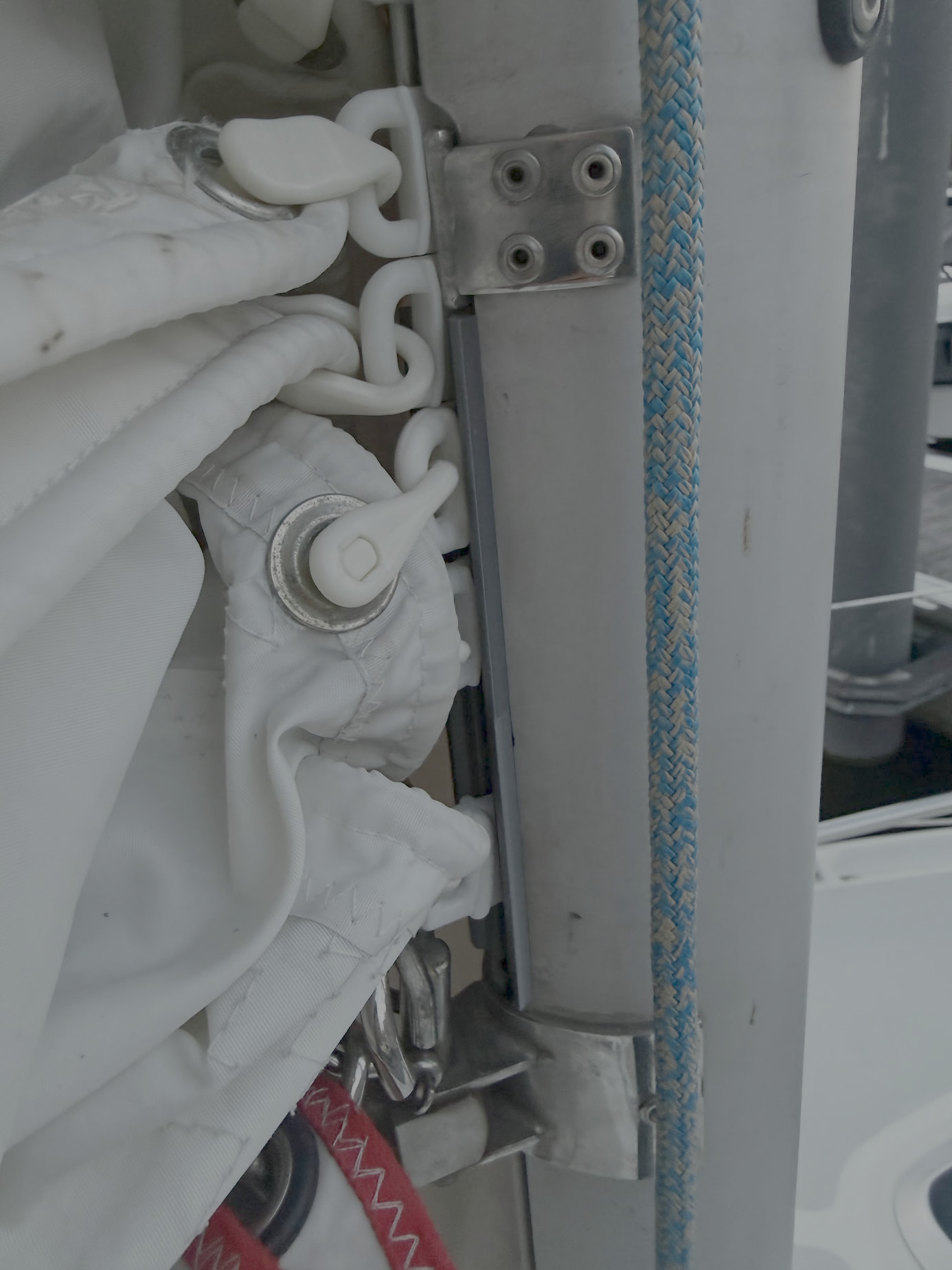

I learned the first few times how annoying is when the slugs come out of the mast when lowering the mainsail or reefing. I used a bungee cord to prevent this, and I learned about mast stoppers in other post.
However, this would leave the slugs too high for me, so that the first reef cringle would not reach the hook. I had to remove the coord to put the first reef.
There are some mast gate designs online. Those are a way to close the mast entry so the slugs can go fully down without leaving the mast. But most of them require drilling the mast.

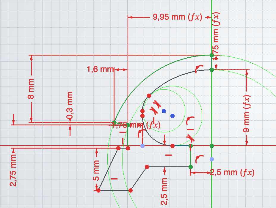

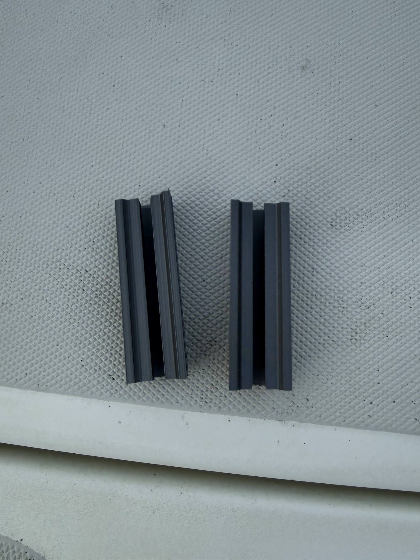

Two 80mm tall C-shape clips that can be inserted into the mast. Pressing laterally a bit they pop up.

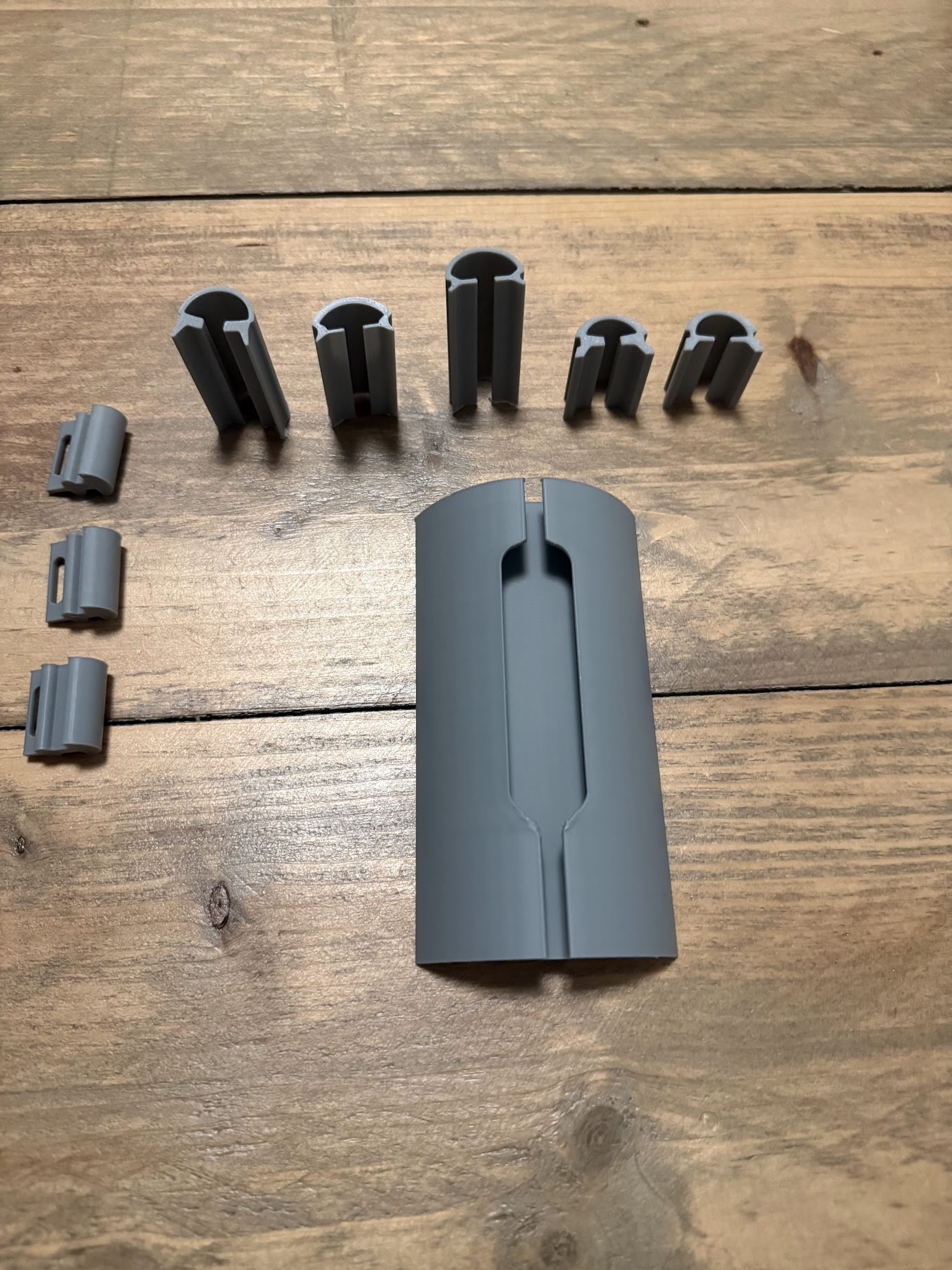

I tried lot of small variations to adjust the flexibility. It’s quite sensitive. I don’t know if all clever 23 are identical. My mast feeders also do not interfere with it.

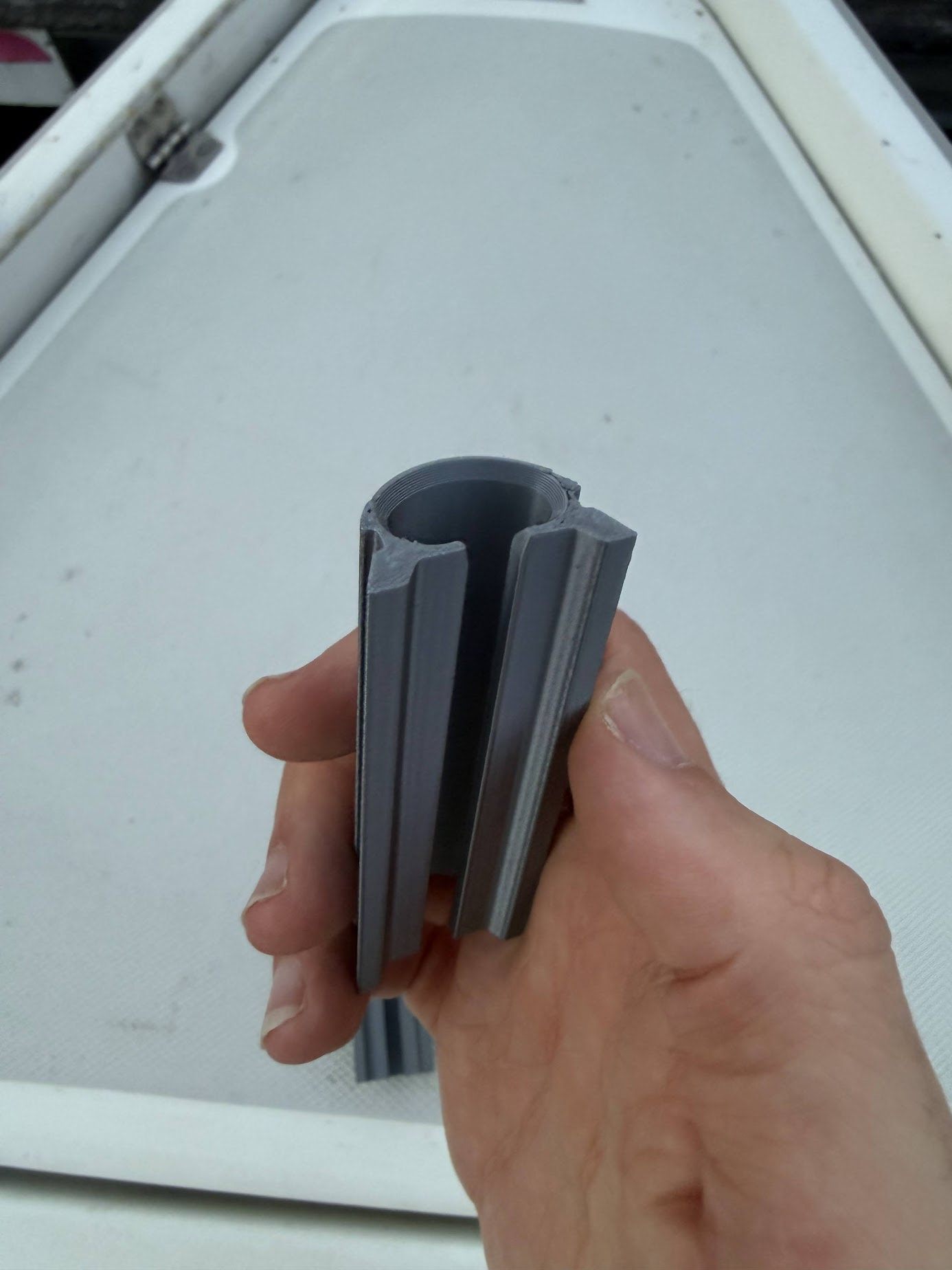

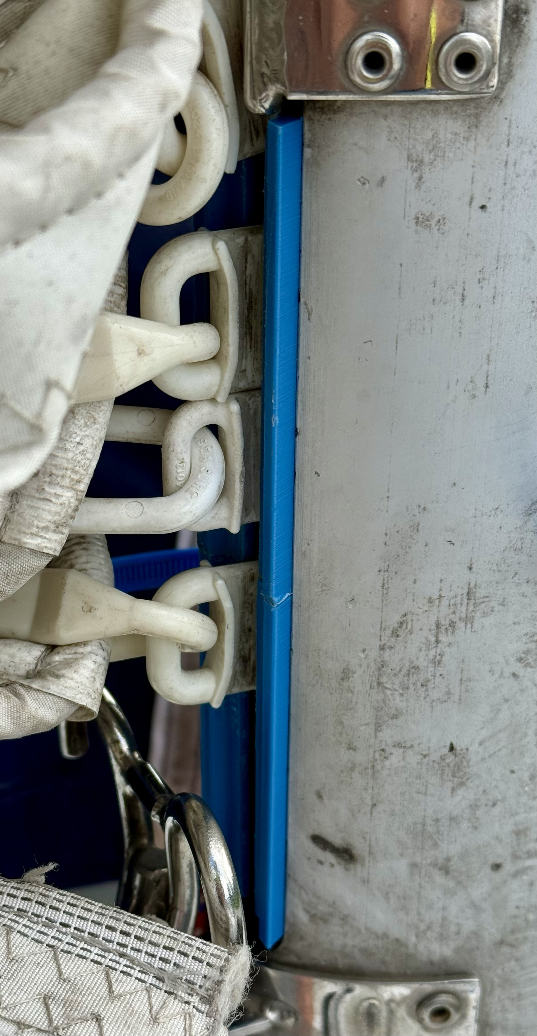

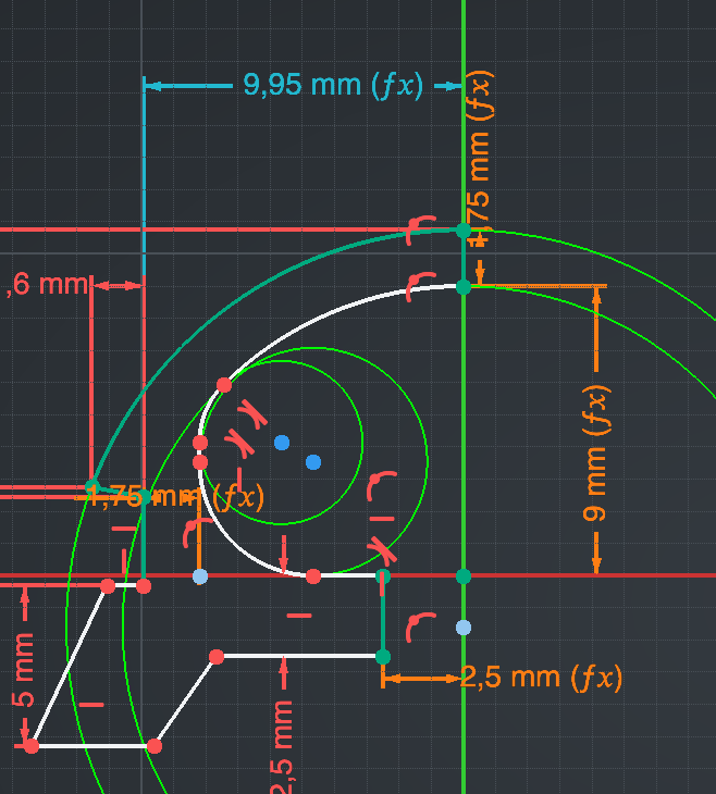

I have tested the stopper. It is a tight fit (on my mast) and the result was that both sides were pressed a bit together and the slugs didn’t fit through. Widening the opening by brought some improvement but I will do some fine tuning later to have it work fine.
Very happy with it; thanks!
Nice. Thanks for trying!
Maybe different tolerances for the printer. This is the distance I adjusted for the fit.
Good luck with the tuning!
To solve the fitting problem, I reduced the design to 95% of the original dimensions and now it fits perfectly. I also widened the opening a bit in order to let the slugs move easier (I suppose that it depends on what type of slugs you use)
